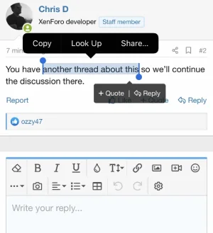

I have had two users report that the reply tooltip is not working. After selecting text, +quote is fine, but not the reply button. It is doing nothing.
user 1: iPhone XR 13.3 safari
user2: iPhone 8, iOS 13.3 safari and Chrome

The steps to reproduce are:
1 Select text
2 Tap reply
Nothing happens
Safari and Firefox, iPhone XS max ios 13.3

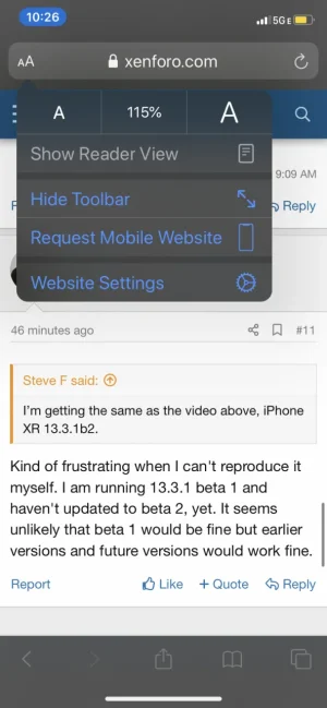

Kind of frustrating when I can't reproduce it myself. I am running 13.3.1 beta 1 and haven't updated to beta 2, yet. It seems unlikely that beta 1 would be fine but earlier versions and future versions would work fine.
Messing around I noticed that under the text/website settings in the address bar my iPhone was set as “Request desktop site” which was definitely causing some weird behavior with text prediction and deleting text in the editor. Switching that off in the site settings has fixed those oddities.
Reply tooltip seems to work better but still had an instance where it simply doesn’t seem to respond.
Chris possibly try flipping yours to request desktop site to see if it acts the same?
