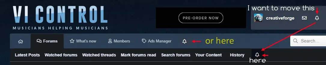

I made our top menu sticky, but now the Alerts icon (bell) cannot be seen when you scroll down.
How could I replicate the Alerts function from the "focus user" section's Alerts, to the sectionLinks navbar? I'm aware I will have two (2) Alerts notifications icons with the red bubble showing the number of notifications.
It would be possible to remove the one located in the focus-wrap-users section, but people got used to see it there. But could I display: none when the sticky menu is enabled when we scroll down?

I added ALERTS successfully to the sectionLinks bar. Why is it ONLY a link? What else do I need to copy there to make it behave just like on the top?

But thanks for asking so nicely. Answer: I did not find any Xenforo fix. I had to edit the theme I use via Xenforo templates. That's probably why it wasn't relevant to post my "solution" here. Too complicated, and not a copy/paste solution.
But I just looked and this is what I find in my EXTRA.LESS template.
// Moves Alerts icon to the left of search
.p-nav-inner .p-navgroup-link {
      margin-left: auto;
// However, remove duplicate of alerts icon on mobile
@media (max-width: 600px) {
    #js-XFUniqueId11 {
    display:none;
// However, remove duplicate of alerts icon on desktop
    #js-XFUniqueId2 {
    display:none;
So obviously you have to find out what to use to replace #js-XFUniqueId11" etc from your own theme you use. However it's not perfect, as for a second both alert bells show up. But I hope it gives you some direction to explore at least.
