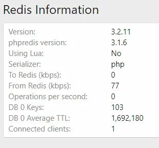

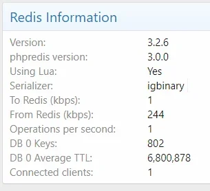

Hi,
on the server i have installed the php-redis version 3.1.1
php-redis ist schon die neueste Version (3.1.1-1)
but the acp show me the version 3.0.0

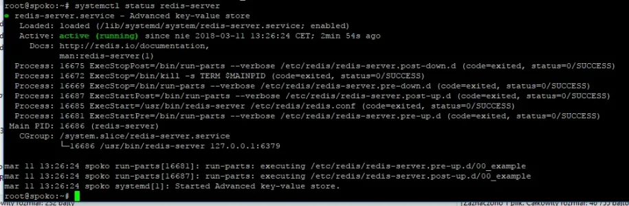

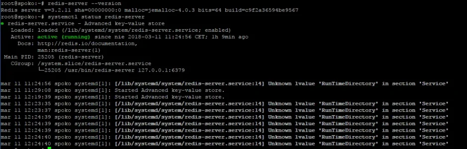

So what I need to run Redis with XF2? I have VPS and I installed redis-server.
# ls -lh /var/run/redis
-rw-rw---- 1 redis www-data 6 mar 11 23:16 redis-server.pid
srwxrwxr-x 1 redis www-data 0 mar 11 23:16 redis.sock

restarted redis by:
sudo service redis-server restart

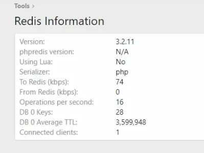

but in admin.php?redis-info/ I still have:
Redis Information
Redis is disabled.
Ok, my mistake. I was editing the old config...
