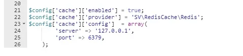

Hi,
When I put that in my config
199675
my forum returns 'unable to handle this request.
HTTP ERROR 500'
I'm positive I got the requirements as well?
199673
199674
I'm using XenForo 2.1 with PHP 7.2
I have also tried changing the '127.0.0.1' to the actual host IP but to no avail. Any guidance would be appreciated.
Thank you!
Make sure you've uploaded the files for this add-on.
Otherwise you need to enable debug/developer mode so XenForo will output an error and adjust apache configuration to display the error to you.

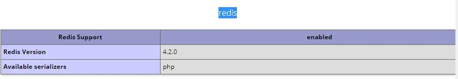

hello,
I installed Redis (PHP extension for interfacing with Redis) via WHM, after that I installed add-on and then I added below code to config.
$config['cache']['enabled'] = true;
$config['cache']['provider'] = 'SV\RedisCache\Redis';
$config['cache']['config']  = array(
        'server' => '127.0.0.1',
        'port' => 6379,
I have faced two problems
1. Forum got blank page
2. It doesn't show Redis statistics in ACP
Where I maid mistake?

Sounds like you followed the steps fine. No idea what it's producing that for you. Do you have a link?

Have you actually started the redis service? Mine did that when I restarted my host until I made redis autostart!
