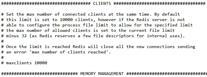

It is the number of simultaneous connections to Redis from php, due to how XF works it is basically a proxy for how many users you have at a given time.
So in my case I have only 1 connected client which is php? and this client (php) is used as a proxy to perform the requests of my forum visitors?
Think I got it, is this okay?
