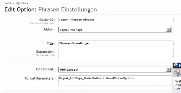

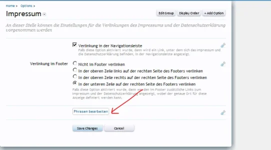

Callback: Can be used to display a "own" options template if necessary.
For example:
