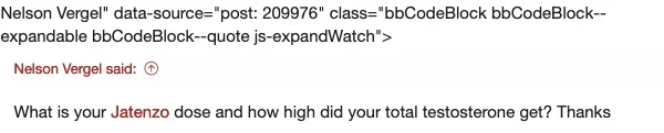

JohnLogar Active member Oct 24, 2021 #1 After the Xenforo update, most quoted information in replies are broken up showing codes in most posts to which people reply in this and most threads. Here is an example. Any one let me know how I could fix this issue? Thanks

Solution P P Paul B Oct 26, 2021 @Chris thinks it might be the Siropu Ads Manager involved. Try disabling that and trying again.
P Paul B XenForo moderator Staff member Oct 24, 2021 #2 Which version of XF? Are you using a third party style? What is the URL to an affected post? Upvote 0 Downvote
JohnLogar Active member Oct 24, 2021 #3 Brogan said: Which version of XF? Click to expand... v2.2.7 Patch 1 Brogan said: Are you using a third party style? Click to expand... Yes, but I tried with default style it's still showing like that. Brogan said: What is the URL to an affected post? Click to expand... The FDA Ended Your Access to More Economical hCG and FSH Aside from Empower, are there any other compounders who are still compounding HCG? Empower is having a supply issue. I found a couple in TX but unfortunately they are not licensed in KS where our facility is located. www.excelmale.com Upvote 0 Downvote

whynot Well-known member Oct 25, 2021 #5 JohnLogar said: most quoted information in replies are broken up showing codes in most posts Click to expand... Seems only Nelson's post are affected Upvote 0 Downvote

JohnLogar Active member Oct 25, 2021 #6 Yes, most posts I have seen are affected by Nelson's posts. Upvote 0 Downvote
nelson vergel Member Oct 26, 2021 #7 Umm...I did not realize that only my quoted posts (I am the admin) are having this problem. Upvote 0 Downvote
beerForo Well-known member Oct 26, 2021 #8 Did you recently change your username, and try to update it in quotes using the find/replace tool? Just a thought, probably not the issue. Upvote 0 Downvote

nelson vergel Member Oct 26, 2021 #9 Thanks @beerForo No change in username or update in quotes using the find/replace tool. Upvote 0 Downvote
beerForo Well-known member Oct 26, 2021 #10 No prob. It just looks like some code is missing. Upvote 0 Downvote
P Paul B XenForo moderator Staff member Oct 26, 2021 #12 nelson vergel said: Umm...I did not realize that only my quoted posts (I am the admin) are having this problem. Click to expand... Is it still happening? If so, what is the raw content you see (disable the bb code editor) when you quote a post? Upvote 0 Downvote

P Paul B XenForo moderator Staff member Oct 26, 2021 #13 @Chris thinks it might be the Siropu Ads Manager involved. Try disabling that and trying again. Upvote 2 Downvote Solution
JohnLogar Active member Oct 26, 2021 #14 @Brogan Yes, you are right. After disabling the Siropu ads addon it's got fixed. Upvote 1 Downvote
