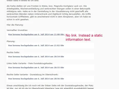

If a private picture is embed in a post and the user does not have permissions to see it, there is only shown a link to the album. On klick an error message appears with an server 403 error - permission denied.
Is it possible to change this link in an static text to inform the user, that this picture is in private?
I.E. "This picture is in private album. You dont have the permission to see it."
In Google WMT all links with error 403 were shown in the crawling errors and an static information would prevent this.

Generally, the 403 errors are correct and won't cause you any problems.
However, there are 3 different Gallery BB Code styles. The "Media Only" type will remove the link. Or alternatively you may wish to edit the template, xengallery_bb_code_tag_gallery:
<a href="{$link}" class="{$type}-{$id}ContentLink">
    <span class="galleryText">{$text}</span>
</a>
There's actually no way to detect a permission error here, though. But maybe it will be sufficient to remove the href="" bit (don't change the class or it will stop the BB code working completely) and you could perhaps add something below the span:
<small>If no media is shown, you may not have permission to view it.</small>
Thanks Chris,
that worked like a charme.
