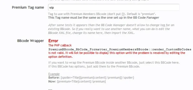

Thanks alot! I wanted to embed a video inside parsedhtml then put that inside a spoiler code and put that spoiler code inside premium bb code.
I've just made a test with the spoiler tag and it's working now. It should be the same with the parsehtml bbcode, can you confirm me please?
I've tested with the parsehtml bbcode, and it looks the content of bbcode (parsehtml) isn't parsed when it used inside another bbcode (
or [premium]). I don't know why and to be honest I don't have much time to see if there is a way to make it work now. You might ask Darkimmortal.

I've modified the PremiumMembersBBcode.php for you to fusion the premium and spoiler bbcodes together. I've tested it and it works.
This file is located here:
library/PremiumBBcode/BbCode/Formatter/PremiumMembersBBcode.php
This works perfectly! I would also like to use the original one though. How could I use this file as a separate bbcode?

cclaerhout updated Premium Members BBcodes with a new update entry:
Version 1.2 released
2012/03/11: v.1.2 released
  • add customized premium and customized private bbcodes (so now there are four bbcodes)
  • new function to wrap these bbcodes inside another one (automatically)
  • bbcodes php code has been rewritten
  • these bbcodes can now have options without breaking the security of their content
  • To upgrade: upload files on server, import addon xml file and import new tags xml files.
