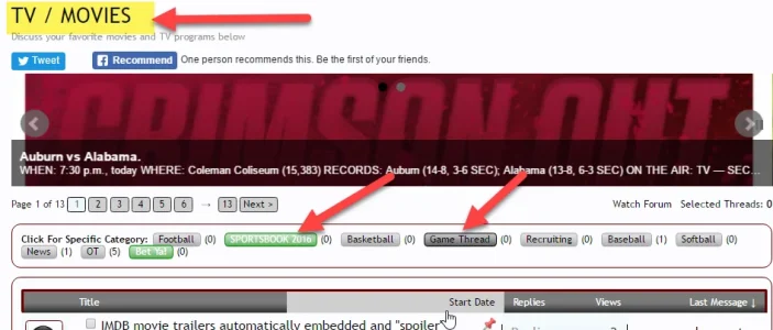

@Stuart Wright Is there a conditional phrase where I can eliminate certain prefixes from specific forums?
IE: On this forum, designated for TV/Movies, I'd rather not have sports related prefixes. Ideally, I'd like to have prefixes for TV/Movies, Politics, etc. on that forum and only have sports prefixes on those forums.
