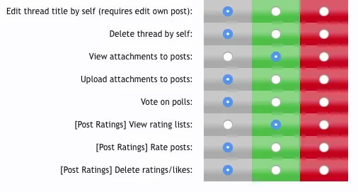

For some reason, I'm unable to allow guests to view guest ratings lists. When logged in, it works perfectly. For Unregistered, Unconfirmed, I've set [Post Ratings] View rating lists: to allow.
Any suggestions?
Confirmed, seems to be a regression here, will get this sorted for 1.7.2

  • Fixed ‘view rating lists’ permission being forced to deny for guests
