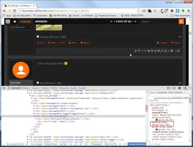

Bought and installed and working nicely :)
But I'd like it to take up slightly less screen real-estate.
I can change it in the browser development tools from this
to this
so I've changed just the padding and margin-top in my browser and I'd like to applly these changes to the style.
Problem being, I can't see where to set this in the template? (I can fudge my way through simple edits, but easily get out of my depth...)
I tried in Edit Template: dark_postrating.css but I don't see the corresponding entries to change.
Am I looking in the wrong place?
thanks,
James :)
to this
thanks,
James :)
Just add this to EXTRA.css:
.dark_postrating { padding: 1px !important; margin-top: -4px !important; }
