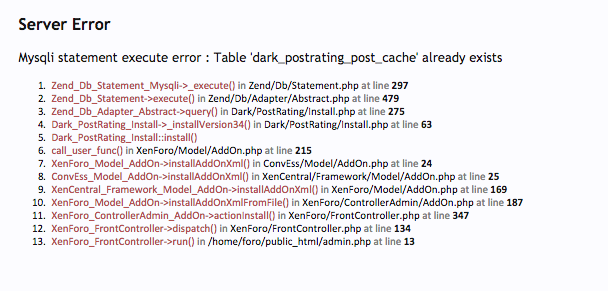

trying to re-install the addon, and now have all that errors.

Thank you for providing FTP details - I have now patched the most positive ratings bug on your site. A fix will be included in 1.7.1 for others with the issue
