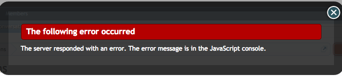

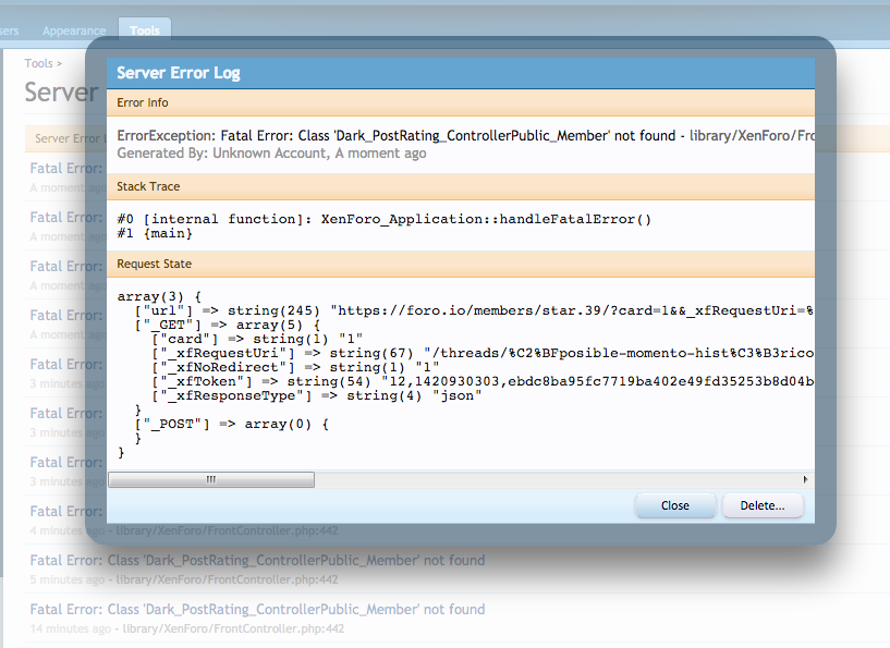

After clear installation I'm getting this error. how can I fix it? Appreciate some help on it.
That would indicate the PHP files are not correctly uploaded - try re-uploading the contents of the upload folder in the zip file

Thanks for your reply Luke. I've already re-uploaded the php files but I'm still with the problem.
"The server responded with an error. the error message is in the javascript console"
any recommendation?
any recommendation?
