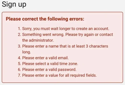

Correcting my previous reply to make it clear so you can reproduce the error.
1. Go to the registration form
2. Go directly without filling any info to the bottom, thick on "I agree to the terms and rules." and click Sign up
3. Refresh the page from the browser ... You will get the Error list and you will find in the list (7.Please select a valid time zone.)
As you said, the value still sent to the server even the field of time zone is hidden, so the error shouldn't show up at all.
This is the problem and ultimately expected. The registration form uses a changing key which helps thwart automated registrations. By refreshing the page, the submitted data is using the old key and thus not picked up.
If the field not mandatory and always selected & hidden, why that error message appears. I think it should be removed from data submission checking.
