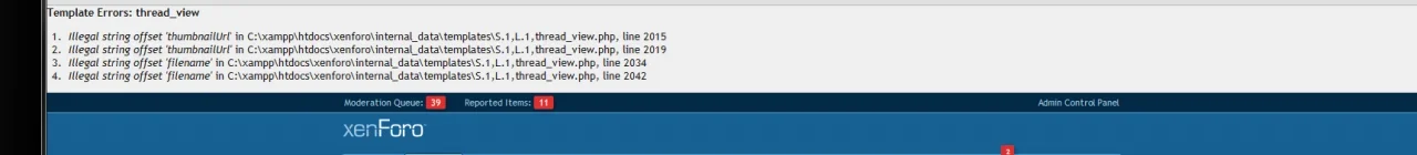

since i updated php to 5.4 on my dev machine, i'm getting this error while viewing threads:
i thought that it's from an add-on, but after spending 2h with add-on deactivating & activating, the bug didn't disapper.
the other strange problem is, that i've installed 2 other vanilla test boards but on only 1 i'm able to reproduce this.........
after ~ 4h i'll give it up
mike it's your turn:p

Seems to also affect personal conversations as well (PM)
Template Errors: conversation_view
    Illegal string offset 'thumbnailUrl' in /home/*****/public_html/forums/internal_data/templates/S.1,L.1,conversation_view.php, line 1150
    Illegal string offset 'thumbnailUrl' in /home/****/public_html/forums/internal_data/templates/S.1,L.1,conversation_view.php, line 1154
    Illegal string offset 'filename' in /home/****/public_html/forums/internal_data/templates/S.1,L.1,conversation_view.php, line 1169
    Illegal string offset 'filename' in /home/***/public_html/forums/internal_data/templates/S.1,L.1,conversation_view.php, line 1177

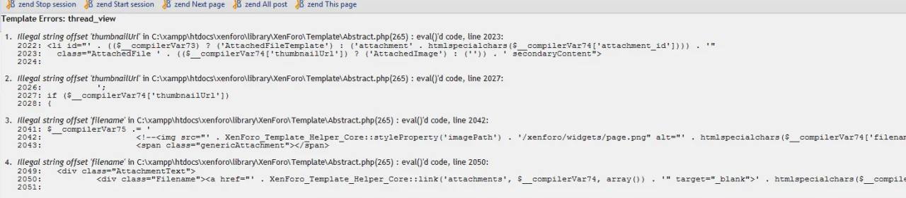

This error is bug: https://bugs.php.net/patch-display....abling_bad_string_offsets&revision=1323002696
In 5.5 this bug is fixed. In 5.4 need patch or change code for use isset in array keys.

Originally, I installed an empty board without testing it properly. The errors can be addressed very easy by editing the attachment_editor_attachment template to match the following content:
<xen:require css="attachment_editor.css" />
<li id="{xen:if $isTemplate, 'AttachedFileTemplate', 'attachment{$attachment.attachment_id}'}"
	class="AttachedFile {xen:if 'isset({$attachment.thumbnailUrl})', 'AttachedImage'} secondaryContent">
	<div class="Thumbnail">
		<xen:if is="isset({$attachment.thumbnailUrl})">

This is not a PHP 5.4.0 bug, is simply related to properly writing a boolean type condition.
I was wrong. It's still a bug. The absence of a key in the array should not cause this warning. In the link about it and said. In particular there is a solution, and information about the patch in the release.
But in some of the RC version 5.4 this bug was. It is possible that some Linux distributions, and build on Windows could not be collected from the release, and from the RC.
Work on the 5.4 release XenForo should be correct without the need to change templates.

Related to what you call a "bug", in my books it is not. In PHP 5.4.0, the illegal use of string offsets causes E_ERROR instead of E_WARNING (PHP 5.3.x). This is a quick example:
PHP:
<?php
$i = ceil((1 * 2) / 2);
$var = 'foo';
// notice
var_dump($var[$i]);
// warning
if ($var['key'])
	var_dump($var);
// fatal
unset($var['key']);
The above code produces the following warnings/errors:
Notice: String offset cast occured in /var/www/axivo/error.php on line 7
string(1) "o"
Warning: Illegal string offset 'key' in /var/www/axivo/error.php on line 10
string(3) "foo"
Fatal error: Cannot unset string offsets in /var/www/axivo/error.php on line 16
Note that there are no array keys set, yet the var_dump is executed (which it should not, but you get the warning so you know your code is wrong). In my books, the previous PHP behavior was wrong and I'm glad they correct it. PHP is leaning toward a more strict, structured language and those kind of warnings/errors are the example of it. Obviously, everything is logic: "Hey, where are you going with $var['key'], this is not an array!"
In other words, there is a need to edit the templates if you want to comply with proper PHP coding, until Mike fixes the issue in Xenforo code. Everything relies (I think) on the way array keys are set into _prepareAttachmentForJson() function.

The proper way to write that code segment is:
PHP:
if (isset($var['key']))
	var_dump($var);
Let me repeat what I said into previous post: "PHP is leaning toward a more strict, structured language and those kind of warnings/errors are the example of it."
