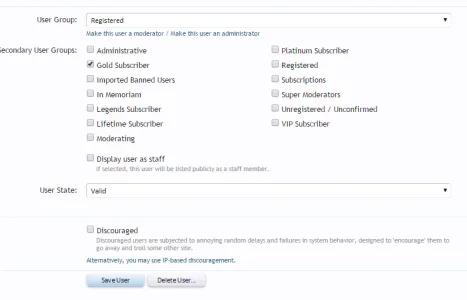

XF is adding them to the secondary usergroup successfully (see attachment), the permissions would be handled by XF from there wouldn't they? This paid user's main group is Registered and secondary group Gold Subscriber is checked. So long as the user has the secondary group checked and that group as attachment permissions, they should have access to the file, regardless of how the box was check, whether that be manual or automated, correct?
