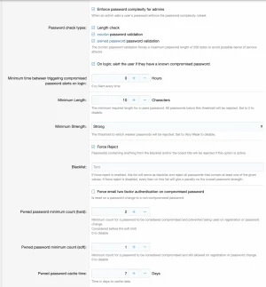

I've got those checked. But it sounds like those are for known compromised passwords. How do I force them to increase the password strength if their password is weak? And, What does password cache time do? Thanks!
That isn't supported, the password cache time is how often hash chunks are fetched from haveibeenpwned and is to limit how much traffic is required. I recommend 5-7 days for that which should be the default.
There isn't really much point on forcing password reset for weak passwords, they are very likely to be part of known compromised passwords and will be detected that way.
