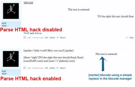

For those wondering, bbcode will not be parsed in any part of the post if [parsehtml] is present, and the AJAX posting does not show parsedHTML, you will need to refresh the page. But it works!!!

I couldn't reproduce the bit about it stopping other bbcode from being parsed however.

The bbcode issue seems to be related to using the bbcode manager and using bbcodes created through that manager, othe rnormal bbcodes work fine, so no problem ^^
NolF
That's what it seems like. I think how it works (I could be mistaken is) it creates a somewhat alternative pathway to render the pages which does not have the callbacks methods from BB Code Manager :/

The callbacks are called statically via PHP, so location doesn't matter. I'm not entirely sure why this would be working in such a way, will try to expose a method for setting extra array parameters for advanced tags such as this with the manager, so it can render an add-on such as this obsolete (no offense Dark...!), where once its written, it could be stand alone or placed into the BB Code Manager, this, in theory could solve your issues. I will continue to investigate this over the next few days. But a quick fix that should work would be to open the file located at KingK/BbCodeManager/BbCode/Formatter/Base.php and replace the function getTags() with the following code:

The solution is not working though :(
After changing KingK/BbCodeManager/BbCode/Formatter/Base.php and removing Dark/ParseHTML/BbCode/Formatter/Ritsu.php I get the following error
Fatal error: Class name must be a valid object or a string in /public_html/library/XenForo/BbCode/Formatter/Base.php on line 1360 contains
PHP:
$tag['children'][$first] = ltrim($tag['children'][$first]);
Disabling the parseHTML hack gives the following error
Fatal error: Call to undefined method KingK_BbCodeManager_BbCode_Formatter_Base::_hasOption() in /public_html/library/KingK/BbCodeManager/BbCode/Formatter/Base.php on line 18
I hope that helps you debug the problem :)

Fixed the incompatibility with BBCode Manager, I think.
The 0.03 is still giving me the same problem as reported in post #9. BBcodes using the BBcode Manager callback methods are still not working :(
