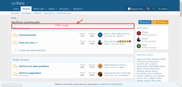

I want to add HTML widget above Forums Topic like image below. Anyone have idea to do it ?
In XF 1, I installed add-on and insert widget in node trees. But i cannot find that way in XF 2.
