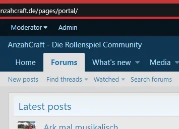

Go to admin.php?nodes/ and click Add a Node
Select Page as the node type:
Set up the Page node and add any widgets you want to the template:
Navigation Section: Home (sets the page to the home tab).
I used
 <xf:h1 hidden="true" />...

You don't need to have a widget assigned to a position on the widgets page. You can have it with no position set and then set it directly in the template as I have above.
That way it'll only appear once.
I covered that above. On the Page node setup:
Navigation section - This controls the navigation section that will be selected when a visitor browses this node. Child nodes will automatically inherit this value.
