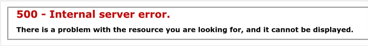

Manual job just keeps tossing server errors. Just gonna let it run on its own and see if its working after that.
Errors was the wrong word. I just get this fella (no actual logged errors). I'm assuming its just timing out, which is why I was gonna let it run on its own tonight.

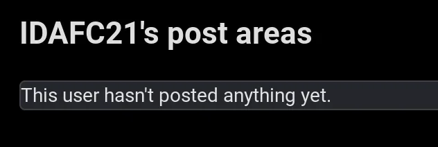

Cron ran but nothing displays. I'm not missing a user group permission I hope haha.
BUT, disabling the cache and it kind of works now. Sadly, its too unreliable, so gonna remove it for now.

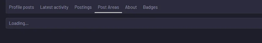

Hello! Interesting addon, I like the concept however when attempted to try it out, it had unfortunately presented me with this issue. No error logs as far as I can see.

I just tried this on a fresh install on a 2.3 site and it seems to be working correctly. What size is the site?
Size as in popularity? Uh not sure exactly. Site has existed since 2018, and has quite a bit of data. I assume, from your question, that it would take some time to get all the data to be easily displayed onto pages?
(Also whilst I am here, is it possible to show specific subforums and only allow their own user to view the page?)
