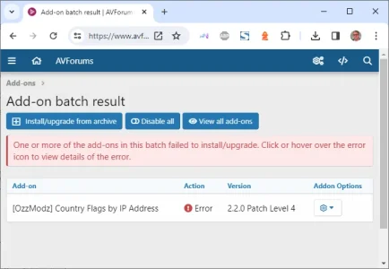

@Ozzy47 Error when updating from 2.2.0 Patch Level 4 to 2.2.1 from the archive:
One or more add-ons currently have actions pending and may be in an inconsistent state. Because of this, some errors may be suppressed and unexpected behavior may occur. If this does not change shortly, please contact the add-on author for guidance.
Exception: Invalid Class: Snog/Flags/XFRM/Repository/ResourceItem
I don't have the Resource Manager installed.
I continued the installation via the action pending item in the addons page and it appears to have now installed ok.
I can't reproduce this.
This was probably caused by incomplete uploading of files to the server or file system/classloader slowdown/bug
I used the Install/upgrade from archive option with the zip, so it wasn't that.
The problem is probably that the install expects the resource manager to be installed.
We haven’t been able to replicate this. Try re downloading the addon, upload the files and rebuild the addon.
Do you have the resource manager installed where you tested it? Can you try installing from the archive where the resource manager is not installed?

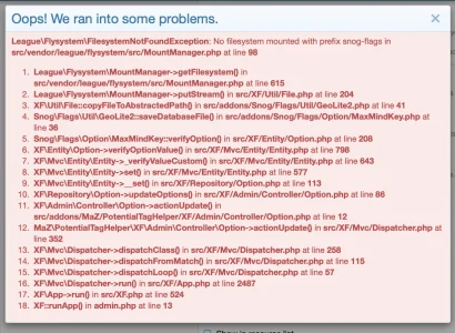

Hi all,
I've tried installing and all good. I enter the Max mind key and upon saving get the following message.
No idea what it means, so any help would be much appreciated.
For reference the forum is using the xenforo cloud based setup.
Thanks

Hi all,
Thanks
Stu.
