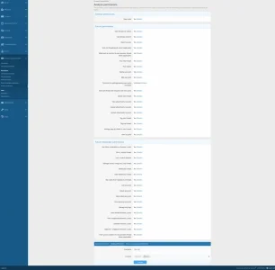

1. I think my moderators can not access the forms. When clicking post thread, it shows this rather than a survey:
2. I checked the permissions via Analyze permissions -> Node permissions -> entered moderator name and selected the forum. Here are the results:

That is controlled by the user criteria in the addon's settings.. If your form is under a type, then first you have to check that type in ACP and look at its user criteria. Could you post a screenshot of that? And then go to the form in ACP and the user criteria of that must be configured correctly. (The user criteria system is a core feature of XF which is found in many addons and in the core software.)
So, much likely your criteria is set wrongly, if you post both screenshots, I can take a look at it.

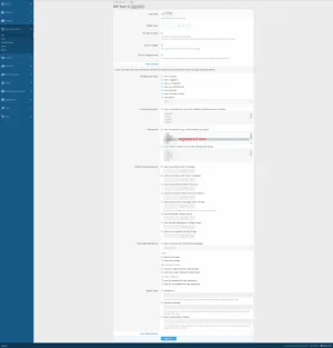

Registered user permissions:

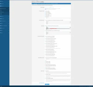

Moderators permissions:
Well, all looks fine. The registered usergroup has access as we can see.

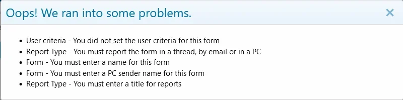

That is not the only thing required for every form, see:
All of these things must be set in each form no matter what.
And the way you explained is the correct way. Selecting "registered and unregistered" as user criteria is the way to go.
I know everything else is required, the others are fine, was only querying the user criteria.
