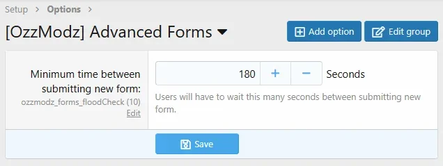

2. When I want to submit a topic, it shows: Oops, you must wait for 168s then you can continue to produce.

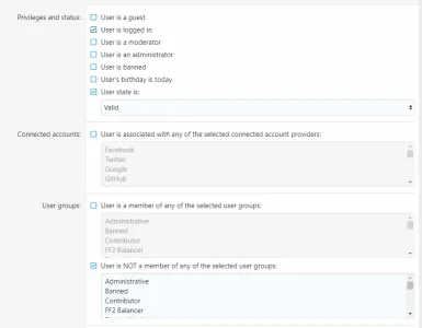

I found another issue.
I had a form type with these boxes checked. There was nothing selected in "User is NOT a member of any of the selected user groups".
However on the form itself I had this checked.
The permission didn't work until I checked the appropriate group in the form type.
This group permission doesn't seem to work either. You can still view forms with this group permission.
There is an option to change flood check time limit. Does it work for you?

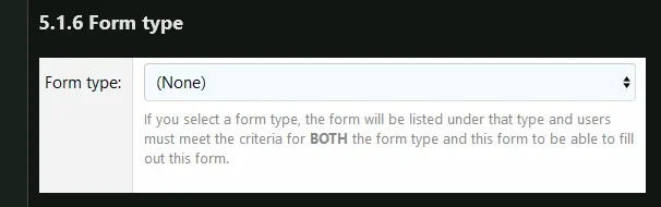

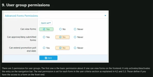

As explained in the documentation, the user group permission has a different role, so it works as intended. It does not configure access to the forms, it only enables/disables the navigation bar. So technically you can disable the entry on the navigation bar, but with a correct link one can still access the form (if the criteria are met, which I will talk about after this).
So the "real" permissions are set inside the type and the form itself. Those should work without a problem. I cannot tell from the screenshots what you expected to happen.
To note is that the permission for type and form are independent from each other but if the form is "under" a type, then you must meet both criteria. Read the description:
Say, you have a type A and a form A (which is under type A).
If you want the user to see the type A, he must meet criteria for type A.
If you want the user to see the form A, he must meet criteria for type A and form A.
My report demonstrates that this failed. The user was able to see the form even when I specified user is not in the group "report banned". It was only after I specified that in the type that it worked.
Hmm, this is strange and makes no sense. It could be a bug, I need to test it when I have time.
From your explanation it makes no sense. Same criteria system for type and form. If it does not work for form, it shouldn't work for type either. Yet when you put criteria for type, it worked, but it didnt work when you put the criteria on form.
Are you running the latest version of the addon?

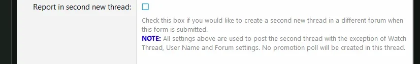

1) Would it be possible for the form to create two threads on user submission? I wanted one for public view and one for private for feedback/discussion behind the scenes
2) I know unregistered users can submit forms but would it be possible to create user on submit? If so with assigned rank?
Couple of questions I couldn't get answers to while pre-purchase researching:
Documentation 5.3.3.5 answers the first of your questions: https://snogssite.com/threads/advanced-forms-documentation.3677/#message-anchor-5335
1) Yes, this is possible. Obviously the 2nd target forum should have the right permissions so it is not open for public view.

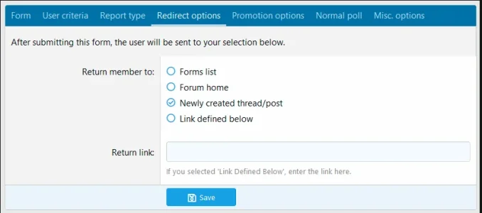

2) Definitely not possible. How would it work? You need to enter e-mail and password for user registration. Should it magically assign a pw and email?
What you can do is to use the redirect option, see 5.4: https://snogssite.com/threads/advanced-forms-documentation.3677/#message-anchor-54
So, after submission, you can have the user redirected to a defined link, like the link to the registration form. This is the closest thing you can do.

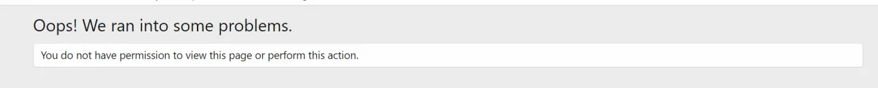

I have a problem with moderators using this plugin. My moderators can not submit a new thread. They just see:
Admin and registered users are ok with it.
Checked many times about moderators' permission, can not find where are the problems.
Please help me if you know how to do it, thank you so much in advance.

If they can't submit a new thread, it means the problem is not within this addon. This addon only has permissions and criteria setup for who can access the forms. Since your moderators can access the forms, it means it works.
So, in conclusion you have to check your node permissions. Can your moderators create a normal thread in that node where that form supposed to create a thread? From your description your mods have no permission to do that, so the form addon can't create a thread because of that.
What more odd is that I assume you configured your permission system wrongly because every user (including admins and mods) should be in the "registered" usergroup. And since you say your registered users can submit, automatically mods should be able to do, too. But you probably made a mess with your usergroup/node permissions, which is why it doesnt work.
You can use the "analyze permissions" feature to find out, go to ACP->Group & permissions -> Analyze permissions -> Node permissions -> enter moderator name and select the forum.
