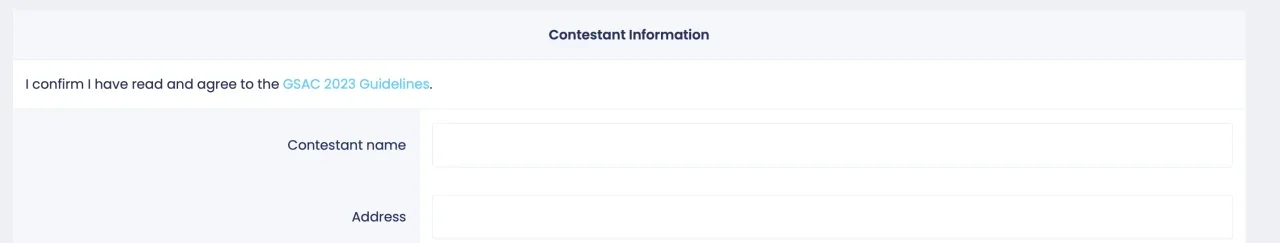

Hi - the agreement option does not generate the click box next to the question. Can you please look into this? Thanks.
Also, the upload file option is not working. It doesn't show up in the form. I'm on the latest version of XF.
Screenshot?

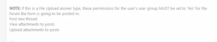

Have you checked these:
Also to remember that per form only 1 attachment button can be used and that is always on the buttom of the form.
The above is an agreement text that doesn't have the square check box.

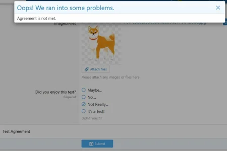

I can confirm that there seems to be an issue with the agreement function.
The "Question or Header Phrase" is "Test Agreement" and is present but the "Description" text is missing as is the option to complete the agreement. If this is set to a required field, the form cannot be completed. (Agreement not met is the custom text set it in the "Question error" field for the form...)
I see, thanks.
@Painbaker The "Agreement" question answer type seems to be bugged and not working.

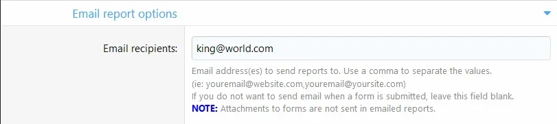

I am not attaching an upload to a thread or post. It is just emailing.
That never worked as far as I know. See the "note" under the report options for emails.
Hmm, I didn't see this fine print.

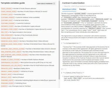

This plugin can be used to perform a kind of contract like this?
Templating like that is not possible.
The addon limits the answers to rows. It means all answers are on their own rows like:
Hello this is my audio stream: {audio_streams}​
{audio_streams} <- This is my audio stream​
This {audio_streams} is my audio stream​
Or at most on a new line or two new lines likes:
Hello this is my audio stream:​
{audio_streams}​
{audio_streams}​
So you can move the answer on the row. Like place it at the end, in the beginning, in the middle, or even place it on a new line but you can't go outside of this like a full templating.
