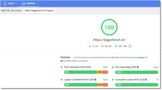

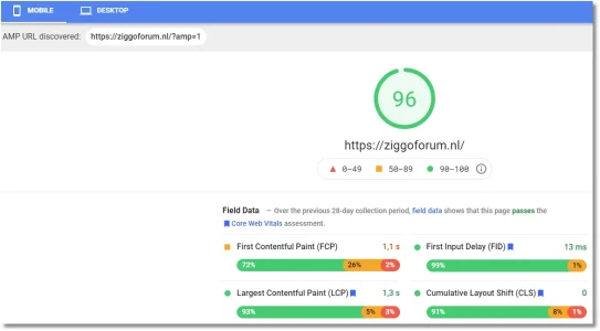

Although I haven't found any theme that does a better job than the default XF theme, I made big progress:
Mobile:
Desktop:
Ok, I must admit, this is with Google Adsense disabled. I'm really struggling with this because Adsense gives me some nice amount of money, but it such an impact on my website. All those cookies, javascript and dozens of external downloads from weird advertiser.
It's not only slowing down things, but security and privacy are also huge topics.
For now, link replacements seem to do very well for monetization.
Other speed improvements I did:
  • Switched to a faster VPS with Centminmod
  • PHP 8 with PGO and JIT enabled
  • Activated Redis guest page caching (finally working correctly on this new server)
  • Reduced Font Awesome size with Kirby's add-on (still in private beta)
