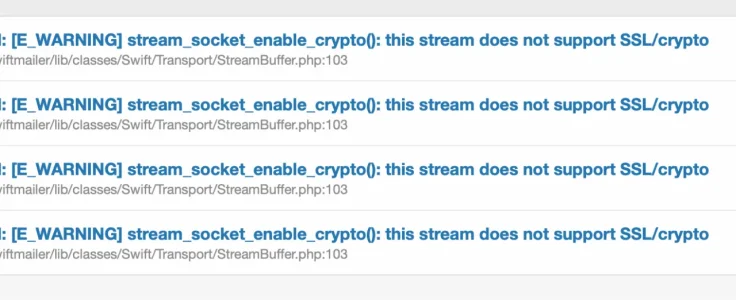

I don't know whether this should be regarded as a bug. It might be a matter of improvable default behavior.
I switched my server OS to FreeBSD since my recent server migration.
However, PHP 7.4 on this platform does not pre-install a lot of usable components.
I got all of them installed.
However, my forums still failed from sending outbound verification emails (SMTP) until yesterday I installed PHP OpenSSL component occasionally.
May I assume that PHP OpenSSL component is expected to be regarded as one of XenForo mandatory server requirements?
i.e.: please improve the server requirement check in "XenForo Requirements Test Script" and XenForo installer & upgrader & AdminCP.
