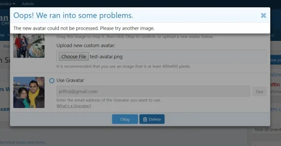

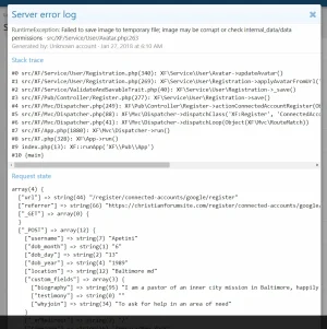

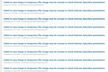

Hi, I found a few errors in the server log which says: Failed to save image to temporary file; image may be corrupt or check internal_data/data permissions
I then checked within the forum if I can change my avatar and I could not. Any idea what might be causing this? Thanks.
Screenshots below:

In my case, I had upgraded php from 5.5 to 7.2. Installing PHP extensions gd and iconv was what actually solved the problem.
