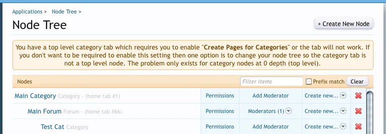

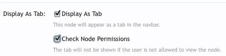

Enable the permission option for that tab:
Then deny access for guests:
Admin CP -> Applications -> Display Node Tree -> Permissions -> Unregistered / Unconfirmed
Revoke all.
