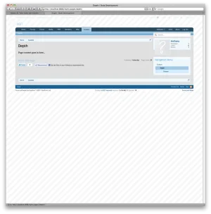

I use a code editor, then paste it in. Quickly creating two templates, cutting out the relevant menu from the pagenode_container template that controls the menu, a few css changes, and now the menu replicates correctly in the sidebar instead of the page itself.

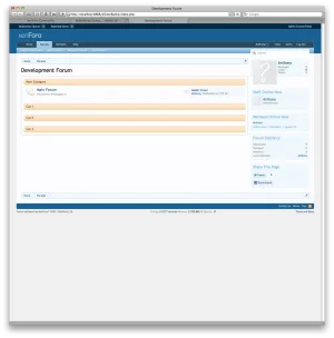

Yep... you could do anything... for example, quickly creating 3 categories:

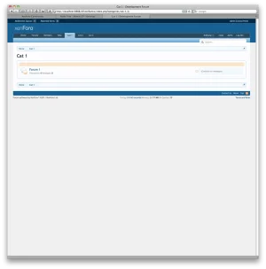

Then shift them to tabs, create a forum under cat 1:
Now ditch the navigation and customise it... split the default XF one out, you could do that with all categories, then create a custom forum homepage by rewriting the template itself.

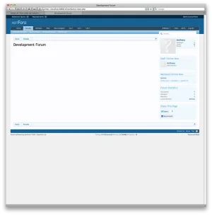

Showing the forum homepage without any categories shown, but instead all assigned to tabs:
