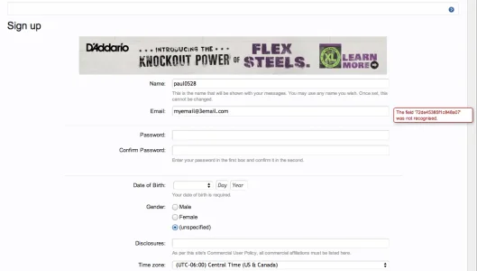

Since midnight last night nobody can log in. Upon login attempt, we're just routed back to the originating page, not logged in... Any ideas where to start troubleshooting?? Nothing was installed or updated at all. Resetting browser cookies has no effect.

And, get this error when trying to register a new account:

Have you customised the register_form template at all?
I was seeing that error for the name field also, before entering anything else but I can't even get your site to load now.
Try removing the ads and any other JavaScript content from that page and test again.
Disabling listeners in config.php is mostly designed to be a fallback if all else fails. Full add-on disabling should be done through the control panel. (Those field names would be related to an add-on, which may use template modifications.)

Fundamentally, sessions don't appear to be maintained from page to page, which would likely imply that the IP is changing constantly, which further implies the addition of a reverse proxy. You would need to figure out where the real IP is stored in $_SERVER and set $_SERVER['REMOTE_ADDR'] to that in config.php.
Fixed! Server tech discovered memcached had crashed, lots of memcached errors were in the logs. Restarted memcached and all is well.
