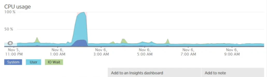

You can see the time where I tried the addon again while set to process 5 items at a time.
I also tried 1 item at a time, which stressed my CPU in a similar manner.

No, it started to error and then brought my server to a halt (all sites went down) after about 40,000 images. I uninstalled the addon. Now when I reinstalled it and enable it again last night, I'm assuming it started over scanning them from the beginning. Hopefully it knows which ones it already optimized and leaves those alone.
When I tried this last night, the server load started to go up right away. I turned the addon back off when the load got to about 16. But there were no Admin CP errors at the time, which I'm assuming is because it didn't get to the point where it was actually optimizing any new images.
So the answer is no, I haven't optimized all images. The load on my CPU is too great to get there.
