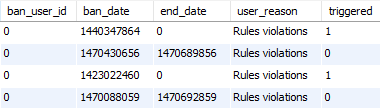

In that thread, it's mentioned that the ban_user_id is intentionally left as 0 which is annoying but fine. It's also mentioned, however, that the triggered column should be set to 1 if the ban was caused by a warning action. For us, it looks like some banned users have triggered set to 1 and some are 0.
Looks like the permanent bans are triggered but the temporary bans are not. What's weird is (A) the inconsistency and (B) that all of our warning actions are temporary bans, not permanent.
Thoughts?

I understand that, but I think you missed my issue. In the other thread, Chris said a warning action should result in a ban with triggered set to 1. Our temporary bans caused by warning actions don't have triggered set to 1. That's what I'm trying to figure out.
It wasn't an entirely correct summary. If your bans are based on point expiration, they will be "triggered"; if they are time based, they won't have that flag. You can see the logic in XenForo_Model_Warning::triggerWarningAction().
