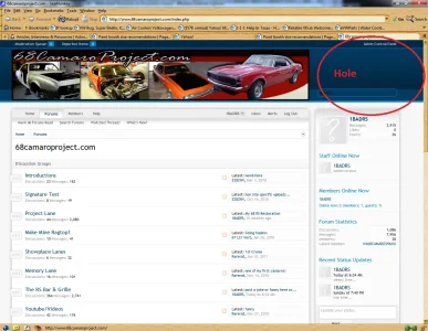

Need help with "hole" in header area
Teddy Scott
What can I do to remove this "hole" or at least make it smaller?
Id really like to move the search box to somewhere else.
Maybe there is something I can put in this "hole" area?
Any other suggestions welcome too.
Thanks!
www.68camaroproject.com
Decent60
Easiest way would be to make your banner bigger to fill it up, or center it instead of aligning it to the left.
There is a place in the templates were you can adjust your search bar's location (I'd just suggest making it lower).
You can adjust the search bar's height by going into the search_bar.css file and finding this line:
PHP:
#QuickSearch
        position: absolute;
        right: 20px;
        top: -15px;
and increase the "top:" number.

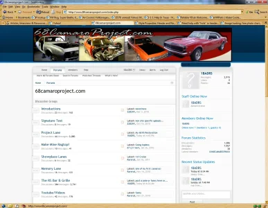

Teddy Scott
yea. i want the logo centered. I had it centered at once point but it put the search bar right on top of the logo.
Ill try to move the search box first then re center. Sounds like a plan. Thanks so much.
ill post back my result
