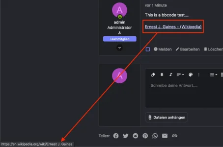

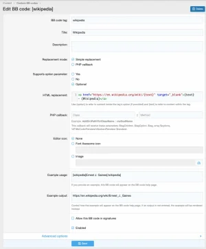

The spaces aren't the problem. Why do you have the url double?
So now the simple replacement code, https://en.wikipedia.org/wiki/{text} no longer works. It tries to load https://en.wikipedia.org/wiki/https://en.wikipedia.org/wiki/Ernest J. Gaines which goes to a 404 error page, instead of https://en.wikipedia.org/wiki/https://en.wikipedia.org/wiki/Ernest_J._ Gaines
EDIT: Works fine for me...
