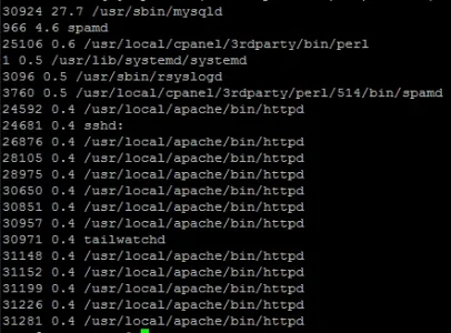

Did they say what's eating all of the memory?
Just because the connections are set to 2.000, that doesn't mean they will all be used.
I'm just assuming that it's usage on my server, but maybe that's an incorrect assumption based on years of my hosts saying the problems are always due to site usage.
I have 5 XF forums running on the server that are only doing about 450,000 pageviews per month. Shouldn't a 2GB linode handle that just fine?
If I run "ps -auxh --sort=size | tac" I see that mysqld is using about 26.5% of memory, then "nscd" then the rest are just tiny 0.x% processes like httpd or pop3.
ps aux | awk '{print $2, $4, $11}' | sort -k2rn | head -n 20
As an example, if you suddenly get a lot of Apache connections (as might happen with a DoS) and you have a reasonably high MaxClients limit, a lot of memory could be used (as each connection would be taking up ~0.4%, so 200 connections would be ~80%, which would exhaust memory).
Not saying it definitively is that, but just giving an example where you can "burst" to use a lot of memory that isn't happening during normal operations.
