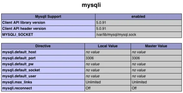

I didn't see anything that indicated that mysqli was installed using phpinfo so I'm wondering what could be stopping me in my tracks. Anyone?[/FONT][/SIZE]
You should see a mysqli section in your phpinfo, like this:
If it's not there then mysqli is not installed.
