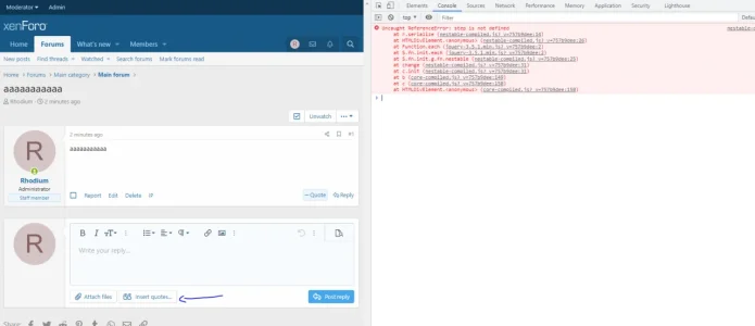

Fixed Multiquote bug 2.2.7
Same here. Good to know it’s known!
I am restoring to 2.2.6
I did a test install but that is one thing I didn’t test, still have that install if you want to see it
If you re-download the package from the customer area and grab the following files:
js/vendor/nestable/jquery.nestable.js
js/xf/nestable-compiled.js
src/addons/XF/hashes.json
... and overwrite the files on your 2.2.7 installs then things should be working fine (and the file health check process should work fine).

Could this not be released as 2.2.7 Patch 1 so it can be applied from the ACP for those who already upgraded?
Multi-quote as a feature is off by default so used by a smaller subset of customers and as far as we can tell very few people actually downloaded the update prior to it being patched. Yes, a Patch update might be more convenient but it's not exactly onerous to download three files and upload them if you happen to be affected (many won't be).
