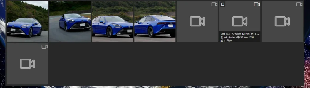

When adding a video into a media gallery via upload of a local file (MP4) we don't get any thumbnail for it in the album.
If we do it via YouTube url then we get the thumbnail with no problem whatsoever:
I would also submit the idea that just showing the image (or lack thereof) is not good enough for a user to figure out what's in store behind it, it's bad interface design.
Showing the name of the media at the very least should be the minimum requirement. As it stands we have to hoover the mouse pointer over it to find out what it is.
Now if we have an algum with dozens of movies that's going to be an absolutely nightmare to manage.

1) Why aren't we getting the thumbnail (I tried both Imagemagick and default PHP GD methods)

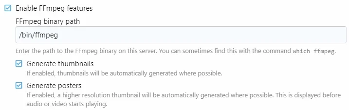

To generate video thumbnails, you need FFmpeg to be installed on the server and then you need to point XFMG to it. This can be done via the "Enable FFmpeg features" option. (You can use the control panel search to jump directly to it.)

I already installed ffmpeg and set it up in the control panel (see above), but still thumbnails are missing (see below):
Also did a "XFMG: Rebuild media thumbnails" and still nothing appears.
What else do I need?

I was about to tell you that something is fishy because I had just installed ffmpeg from a recent package and it would not make any sense for it to be so old. Then I realized that maybe the "which" command did not return the latest package installed and... bingo... the most recent one was on another location.
This is the correct ffmpeg version, for which I already updated the correct path in the ACP and the thumbnails got generated fine:
