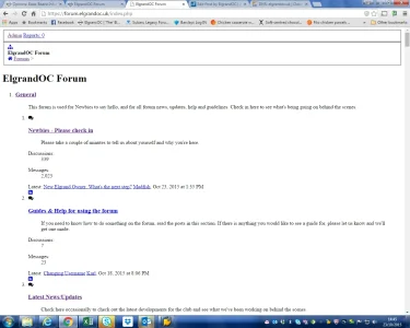

I use cloudflare to provide basic SSL cover for my website.
At the moment, I have http://forum.elgrandoc.uk set up to work through the cloudflare service to give me https://forum.elgrandoc.uk
Now, if you click both of the above links, you will see my problem.
I have changed the settings in ADMIN > OPTIONS > BASIC BOARD INFO > BOARD URL to read both http and https... but neither of them seem to work.
Any idea what's going on?
When I used phpBB this worked fine, and I have a rule enabled to force https. What have I done wrong?

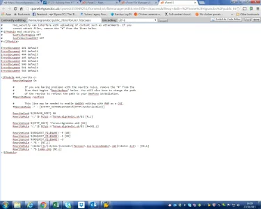

Try this in .htaccess
RewriteEngine On
    RewriteCond %{SERVER_PORT} 80
    RewriteRule ^(.*)$ https://yoursite.com/$1 [R,L]
    RewriteCond %{HTTP_HOST} ^yoursite.com$ [NC]
    RewriteRule ^(.*)$ https://yoursite.com/$1 [R=301,L]

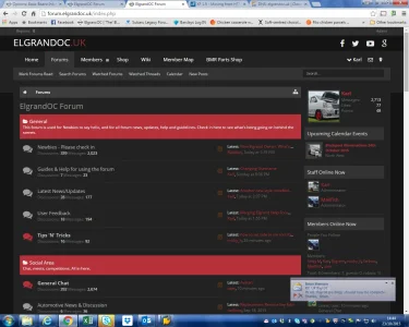

This worked :) Thank you @Mike :D

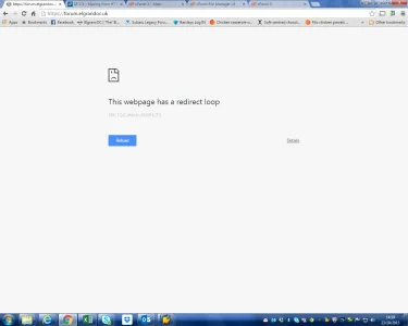

Actually - it didn't work! Users had issues getting onto the site.
I feel this might be something to do with the way I've set up the subdomain... people can still access using elgrandoc.uk/forum which I don't want them to do. But if I add a redirect to forum.elgrandoc.uk I get a redirect loop... any ideas?
