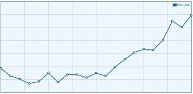

It's actually a little hard to quantify. First, the spam blockers are so much better. I saw a dramatic drop-off in registrations and posts which were both directly attributable to spam that was no longer showing up. From what I could measure, it looked like I only lost spam, not actual users or content. Second, there are a lot more popups/overlays/etc. on XF, so pageviews are going to naturally drop by a small amount. Especially when you consider VB's "interstitial" pages ("thanks, we're taking you to your content now...").
Our organic search hits went down a bit, which could be attributable to a number of things. I changed the posts per page from 20 to 40. Consolidated some of our forums. Purged some old content. Our old classifieds system went away. And frankly, the spam that was getting through (profile spam, especially) may well have been contributing to traffic.
Engagement is up, though. User session duration up. Number of likes is through the roof (the migration happened about halfway through this chart, you can see the instant spike):
Frankly, as much as anything, the site is just better now. Metrics and measurables aside... the mobile view of XF is so much better than the mediocre and crippled mobile skin of VB4. The administration of the site is so much better that it's hard to even express how much. My users liked it, and I have a somewhat vocal userbase that hates change so that speaks volumes ;).
