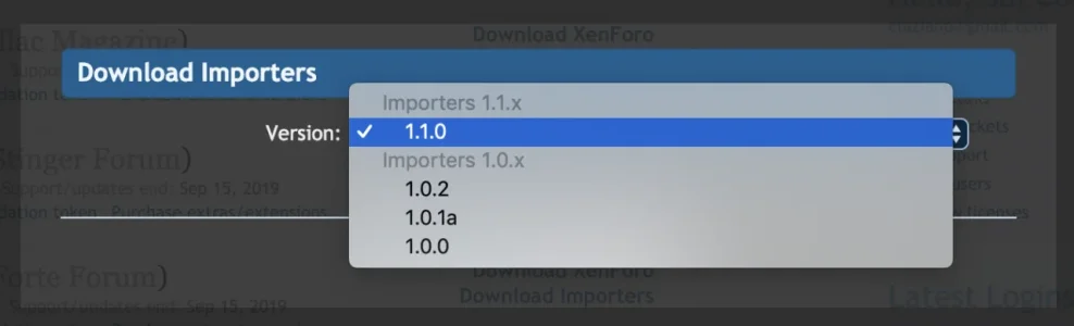

I'd like to import a vB 3.8.11 installation into XF2. The importer bugs pointed out in the section you mentioned aren't an issue. But where is the importer to download? Is it the same importer for XF1?
