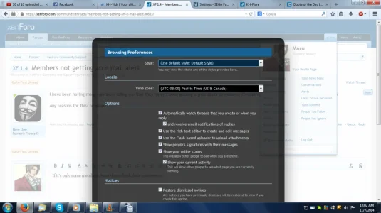

Mine was not related to conversation. They weren't getting alert emails. If they unwatched and watched again then alerts would work.
So basically new alerts are fine but existing alerts failed to notify by email.
That would seem to imply that they were set to watch the thread without emails explicitly. Unwatching and rewatching would do nothing but recreate the same record in one table otherwise.
Well the feedback was coming from staff who know how to use the forum. It was the moderator forum they were watching. Their email alerts stopped after the upgrade and they had to reset them. I've no idea how many of the regular membership it affects.
Is there a way I can run a query to jump start everyone's current settings without resetting them?
No, because nothing changed in the upgrade related to this. The closest change is that there is an option that only sends alerts/emails to people who have been active in the last 6 months by default; simply visiting the forum would be enough to avoid that (unless you have something else going wrong; you can confirm this by looking at the last activity time on the ACP user edit page).
