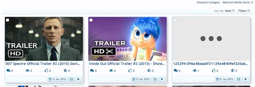

If it is predominantly videos, you could change the thumbnail size so they are a different aspect ratio. The thumbnails, by default, are 300 x 300 so they will appear as squares. If you changed that to be 384 x 216 (which is a fairly standard for videos 16:9 ratio) then they would appear similar to this:
After changing the option, you need to rebuild the thumbnails.
