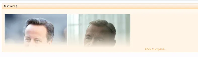

I had Click to Expand disabled for quotes and when you quote media, sometimes it will get cut off. When I reset that setting back to default and you quote the same media, it's all visible once you expand the quote. How can I fix this?

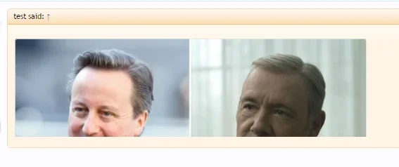

With Style Properties - Max Quote set to 99999px or 0 this is the result - Media is cut off

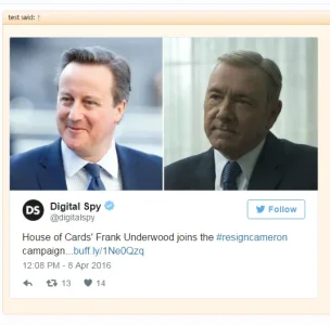

When that setting is reset to default (150px) this what happens
and
Doesn't seem like the max quote recognizes the height of BBCode Media Sites.
