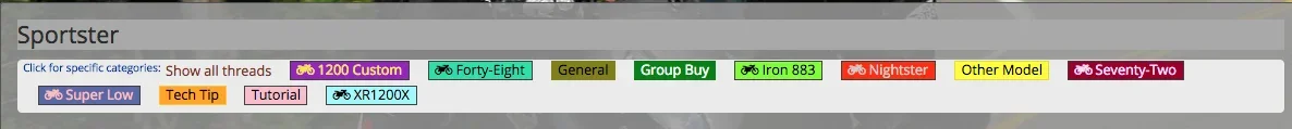

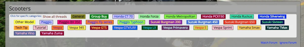

Pretty much what I did with my motorcycle forum. Originally I had a node for each Harley made. There were WAY to many of them. Ended up just having the different families and then used the prefixes for the models. Works out really well.
Screen Shot 2015-04-04 at 1.35.57 PM.webp Screen Shot 2015-04-04 at 1.37.31 PM.webp

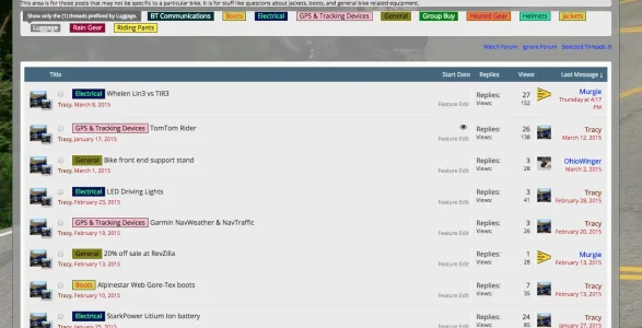

The prefixes can be a VERY powerful tool, if they are used. You can make it so that the user has to select a prefix before making the post - but I don't particularly like the way it does it when they don't select one. The error it gives is not really user friendly.
There is also an add-on that gives that list of the prefixes at the top of the node in the resources area. It allows you to filter based upon a particular prefix in that node just by clicking on the prefix you want.
