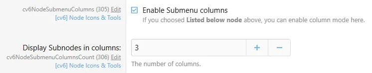

2) Organize into columns for larger format devices (desktops & tablets): Make better use of space for large format device users by using columns. I personally use this on one of my sites with numerous forums: https://xenforo.com/community/resources/cv6-node-icons-tools.5565/
With this setting:

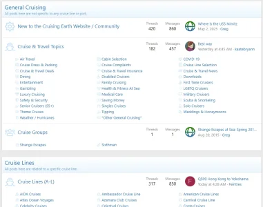

Resulting in this: (it is dynamic and will adjust column count to available screen width, you can further tweak with css if needed)
With this columned submenu layout you can fit 8 times the forums in the same space on large format devices (desktop & tablets) which for forums is typically around 30-40% of your site traffic.
