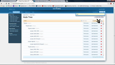

The problem I ran into is that I can't add anymore Categories or Forums. It seems to have stopped at 500 of 500 and wont let me add anymore.

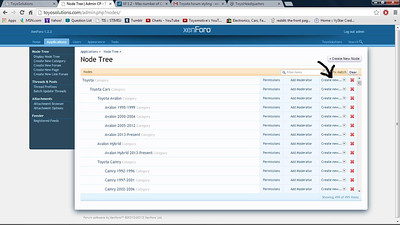

The limit is in the node_list admin template:)
<xen:if is="{$nodeCount} < 500">
               <xen:popup title="{xen:phrase create_new_elipses}">
                 <xen:link href="{xen:adminlink 'nodes/add', '', 'parent_node_id={$node.parent_node_id}'}">{xen:phrase sibling_node}</xen:link>
                 <xen:link href="{xen:adminlink 'nodes/add', '', 'parent_node_id={$node.node_id}'}">{xen:phrase child_node}</xen:link>
               </xen:popup>
             </xen:if>
http://xenforo.com/community/thread...n-nodetree-create-new-function-is-gone.63738/
Please bear with me if I'm not clear on this but I was able to add a category or forum under the Node tree and then Add but that option has disappeared.
After the last entry #500. the option disappears....

You can edit the admin template and remove or increase the limit but I would wait for a response from Mike as to why it is there in the first place.
As stated, you can still create nodes using the button at the top of the page.
I see. Thanks for all the help guys and I will wait for Mike's response (if he chooses too). Maybe they will change this limitation in a future Xenforo Update like 1.3 I am really not familiar using that method but I guess I'll have to learn. I tend to learn using Brute Force/Trial and Error. :rolleyes:
I believe that setting of 500 is only there for the Display Node Tree for performance reasons (admin side). You can still click any category/forum you already have and add a new child or sibling from that screen as well.
It's solely a browser performance thing. As mentioned, you can still create nodes beyond that but we hide the extra popups.
