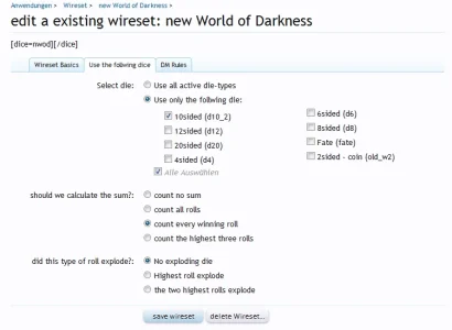

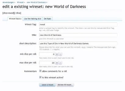

Hoffi
I am writing a Dice Roller with a huge amount of possibilities in the backend. I think late Nov I'll release it.
Hoffi
Sure.
The Backend is nearly done.
What can you modify in the backend:
  • You can define own dice with a couple of options as number of sizes with values.
    eg. d20 normal 20sided die, double 10. 20sided die with two times each side 1 to 10. You can specify own die like: a seven sided die with the values 2,5,6,6,10,11,30
  • The rules, to "win" a roll can be set with PHP Callback functions. Multiple functions are delivered by default like highestValue or rollXTimesOverY.
  • You can build wiresets, that can be rolles. Here you can select 1 to all die, a winning rule and some other options.
  • you can modify the look of the die. Each die can have it's own layout in the frontend. This works with background-images. The dieresult will be text in front of the die.
in work:
  • Icon in Editor, that opens a dialog, to create the bb-code for the roll.
A Code to roll a die may be look like:
[dice=wod]9,7[/dice]
(Roll 9 10sided die with a difficulty of 7 in the set of wod. This set contiains information, that a die may explode).
or
[dice=sw]2*d4-d6-d10,32[/sw]
(Roll two d4 a d6 and a d10 in the set of sw. This set contains the rule, that the sum must be 32 to win the roll).
You can set in the options which Usergroup can roll die in wich forum and in conversations.
the moderator right "delete roll" is implemented.
And finally:
  • integrated into AdminSearch
  • full Phrased
  • a roll can only made by creating a post. If you edit a post, there is only a placeholder for the roll, so that it can't be edited.
